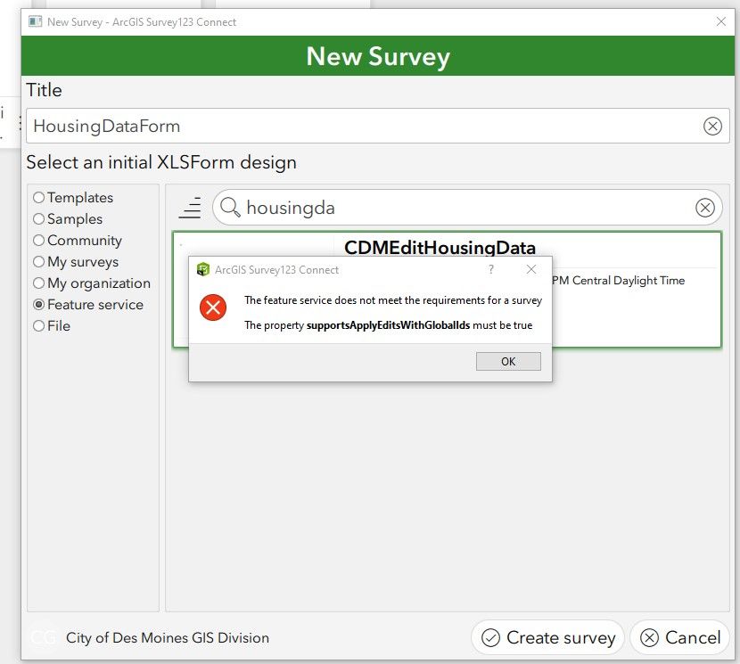

I'm trying to create a new survey via survey123 connect but I'm getting "supportsApplyEditWithGlobaIds" error (below)

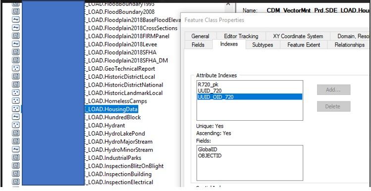

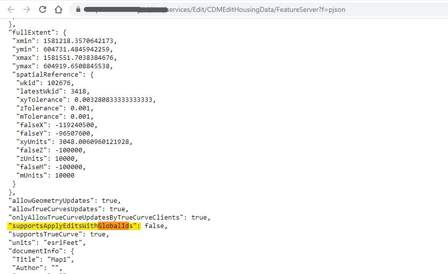

The feature class does have a global id field, in the REST service shows that field as false
Where do I need to go to change that field to true?
Not sure if it's related but the feature class had attribute indexes in two fields (UUID_OID_720), which I deleted and then republished the service with the same result.

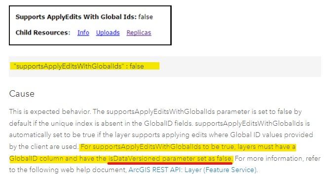

Found the problem, supportsApplyEditsWithGlobalID turns to true by default when the feature class is NOT versioned.
https://support.esri.com/en/technical-article/000017731
