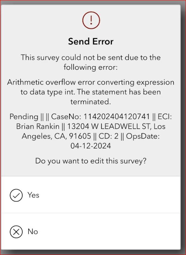

Hello,
I have a complex form that is used for field data collection. There is a team of about 70 users. 3 of those users are experiencing problems when sending a report. The error message is the same for all 3 users. I researched this error and it seems to be a text question with an int return, or something like that. I checked over the xls and can't find a text question with an int field type, or an int question with a text field type.  But why are there only 3 users are being affected by this, and not all field staff? Also, those 3 users can send other reports without any issue. All 3 of them have a record stuck in the Outbox with this error message.
It is a large form, so maybe I missed something in the xls, I have reviewed multiple times. The most recent update was to the instance_name. I used concat when constructing the statement. Could this instance_name update cause this error? The error references the instance_name. Here is the instance_name statement:
concat(${Review_Approval}, " || ", ${ECI_ResubmissionReview}, " || ", concat('CaseNo: ', ${Case_Number}, " || ", concat('ECI: ' , ${Lead_ECI_Name}, " || ", ${Incident_ST_Address}, ", ", ${City_State_Zip}, " || ", concat('CD: ', ${CouncilDistrict}, " || ", concat('OpsDate: ', format-date(${Operation_Date}, '%m-%d-%Y'))))))

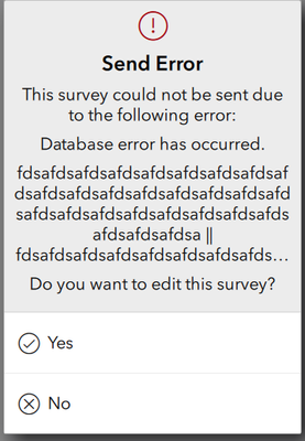

I was wondering if there was a string length issue (e.g., 255) that you may be running into, so I tested that as well and got the standard "database error" (see below). There is a good change you will run into this issue since you are combining so many fields. Either way though, I wasn't able to recreate your error.
