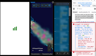

I have been using Survey 123 as an embedded app in Experience. It was showing up fine until yesterday but today I am getting this error.
How can I fix this?

Yann-EricBoyeau
Hi,
We found that non-public surveys (from survey123.arcgis.com) embedded in a non-public 10.9.1 Enterprise dashboard does not display anymore. Everything was working before last AGOL upgrade.
looks like url for sharing survey :
https://survey123.arcgis.com/share/xxxxxxxxxxxxxxxxxxxxxxxxxxxxxxx?portalUrl=https://myportal.mydomain.com/arcgis
does not work anymore (does not ask for authentication or reuse dashboard credentials)
Yann-EricBoyeau
Hi,
we have now a referenced bug for this issue : BUG-000159240 - Unable to add the Map/feature service from a federated server with store credentials as an URL to Portal for ArcGIS when using AD user logins
