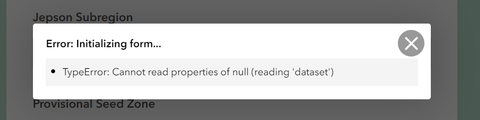

Our survey is giving the error in the subject when opening in the web browser. It works fine in the app, but we need to use it in the web browser. I've tried clearing cache and using different browsers to no avail. Any ideas what might be causing this or how best to troubleshoot?

Please post a screen cap of the error. It will be hard to diagnose otherwise.

Oh, derpy me didn't realize the error was the title... Thank you all the same!
Suggestions (in order):
  1. Unfortunately, my first go-to for this error would try clearing browser cache. But as you stated, that was already tried. So, skip this one.
  2. If you are using Connect, run the XLSX checker and see what it comes back with. Two important things to watch out for are A) An up to date XLSX Form Template, and B) You are not using any reserved words (you should see a green triangle next to the reserved word)
  3. There may be a specific part of the form that isn't web compatible, resulting in this error. In that case, I would create a copy of the form (to avoid unnecessarily interfering with your already published form) and systematically add/remove components of the form until it breaks. Starting from a "blank" form should result in no errors. Just go from there until you encounter an error.
  4. Log a support case with Esri may be a good option.
cmartorano_CNPS
thanks! I do have little green error tags on the select question types for some reason. Still not sure why it works perfectly with the App and totally broken on the web browser. Still troubleshooting...
