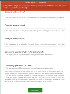

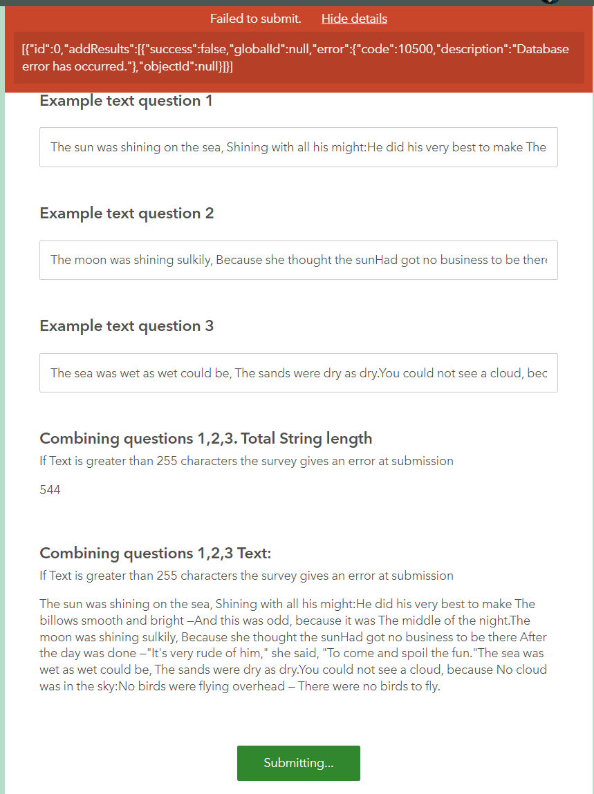

It took a bit to troubleshoot.  It appears if Survey123 tries to populate a field with more than the default characters 255 the survey gives a random error at submission.
  • If the field is read only or hidden, no warning shows in the survey itself
It would be great if the survey gave a clearer error, to flag that the concatenated text contains more characters than a field allows.
Now that I know the error I can either increase the field or use substr(${field},0,255)
The tricky part as this is caused by a combination of fields, shorter fields will combine no problem, and you end up running in circles trying to find what is causing the error.
I have included my Survey123 xlsx to replicate the error

The survey I noticed the issue on is already live, and changing the schema will republish the survey and purge all previous entries.
I am currently truncating the results with substr(${field},0,255), some data is lost but at least the user can input their survey.
It would be nice if the survey gave an error, such as "entry too large for field type"
