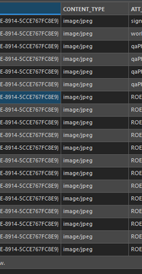

The layer is a feature service coming from an SDE so I opened up the attachment table expecting to see some null values in the content type field but everything was present.
Here are the attachments for one of the features that is giving the error. They all appear in the inbox as existing photos. Any ideas on this would be appreciated!
