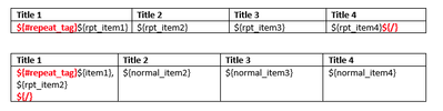

Also, keep in mind that repeats have a specific way that they interact with tables (which you are using in your Feature Report).
If you are spanning columns, a repeat needs to be the first and the last thing in any given row. Check out the examples below for valid repeats within tables:
For some examples of things that are not allowed, check out these invalid examples:
