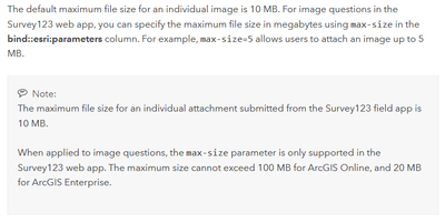

Ya, this is a super annoying limitation that I wish they'd remove...
Here is some more detail on the limits.
