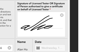

Hello everyone,
I recently came across a blog post discussing some "Survey123 Tricks of the Trade: Groups, Grids and Pages" in Survey123, showing the possibility of embedding the signature function directly into the form without triggering a popup window. However, the exact method to accomplish this wasn't outlined in detail.
Could someone please assist me in understanding how to embed the signature function directly into my form, eliminating the appearance of a popup window using connect? Any guidance or pointers on this would be greatly appreciated!
Thank you in advance!
ChristopherCounsell
MVP Frequent Contributor
I understand this is a screenshot of a completed survey form, including a signature question.
I have not seen any suggestion that signatures or other image questions can be completed within the form directly, without the pop-up. There's no reference on the mentioned blog, documentation or signatures blog that this is possible.
It would make for a great ArcGIS Idea.
