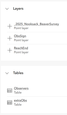

I have a form with four repeat sets of questions, two of them involve geopoint questions, so the resulting related layer/table set up looks like this:

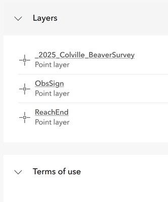

The related tables no longer appear on the item page for the main feature layer, but they're still there on the _form and _results views.

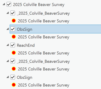

Additionally, when using the Open in ArcGIS Pro feature, the layer list looks like this:
It duplicates the first two layers and puts them in place of where the related tables would be.

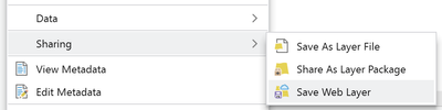

Have you tried submitting a new record and seeing if it appears as it should in your feature layer when you run export data?  I assume you are using Export Data from the feature layer's AGOL item information page.
Save Web Layer doesn't save edits you make to the data, it saves changes you make to the appearance.  It doesn't look like it is supposed to change the source data, just the appearance, so the behavior with the tables missing from the feature layer is strange and maybe worth a bug report to esri.
https://doc.esri.com/en/arcgis-pro/latest/help/sharing/overview/save-a-web-feature-layer.html

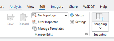

When editing a hosted feature service, the updates are usually automatically pushed, unless you turn off some editing settings that auto commit edits (I've found that the auto commit of edits to a feature service is laggy and degrades performance of making edits in Pro). If you do that, then you should be using the Save/Discard edits buttons in the Editing pane when editing your data.  That will save changes to the data without modifying appearances or feature service schema.
