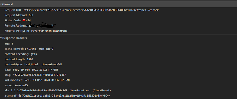

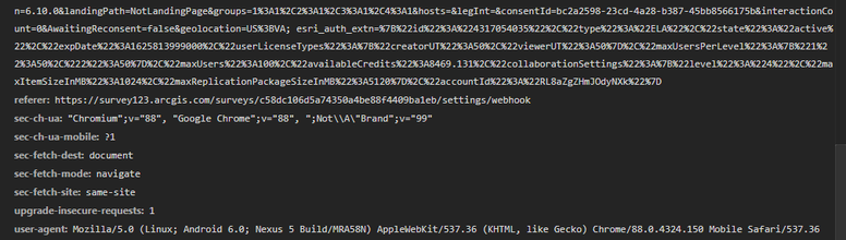

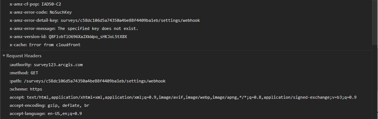

I am using version 3.11.164 and survey connect version 3.11.123. I am actually logged in as a user when submitting the survey.
When recording network activity, I notice the web hook has a status of 404. The information or that line is below.
Also enclosed is an attachment showing the error log.
