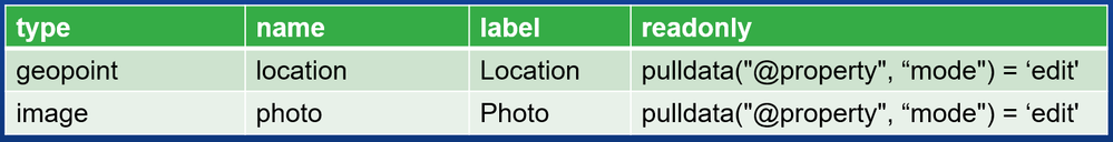

This should do. The output of the expression determines if the question will be readonly or not. In this case, if the record is in edit mode, the geopoint and photo questions are readonly.

You can use the readonly column. If you se the value to yes, your question will be read-only.
Tip: You can also disable the data validation formula in Excel and then type your own XLSForm expression. For example, you can turn your question read-only if the survey is in edit mode (opened from the Inbox) and leave it as read-write if it the survey was opened from Collect (to create a new record).

Thanks Ismael, do you have some example for activate the read-only if the survey is in edit mode (opened from the Inbox) and leave it as read-write if it the survey was opened from Collect (to create a new record)?
