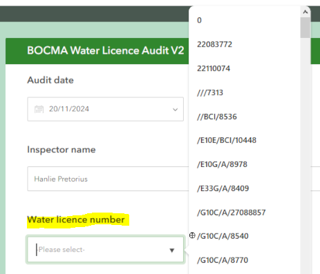

In the web form it pulls in the values and they can be selected:

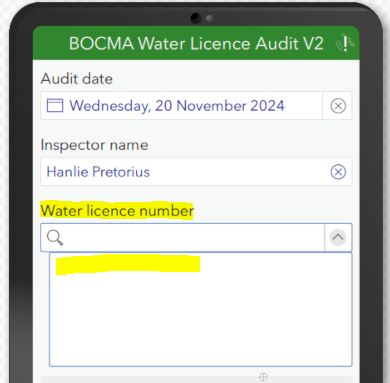

But in Survey123 Connect and Survey123 for Desktop the values are not retrieved:
Any ideas why this might be?

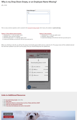

External Selects need to be downloaded separately from the survey.
Exit the survey and return to the main S123 screen. Then, click on the survey and it should download the external select. You should see the list now.
abureaux
MVP Frequent Contributor
Actually, you know what... I send this News Post out at least weekly to internal staff. I may as well copy it here to continue the trend (lol).
(larger version attached)

I created a new survey using a different feature service as source for the list and that worked. So it looks like the service may be suspect. But that doesn't explain why it works in the web form but not in Survey123.

It's also very strange that the list works in the web form but not in the Desktop or Mobile apps.
