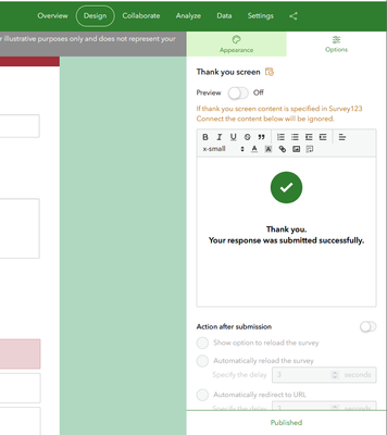

Basically, just open this survey in the S123 Website, go to the "Design" tab, turn on "Action after submission", select "Automatically redirect to URL, and then "Publish":

I tried your suggestion, but my issue is that I need two different redirect URLs—one for respondents who consent and another for those who do not. Enabling "Automatically redirect to URL" after turning on "Action after submission" in the "Design" tab only allows me to set a single URL. I added the URL for those who consent, but respondents who do not consent are still being redirected to the same page.
