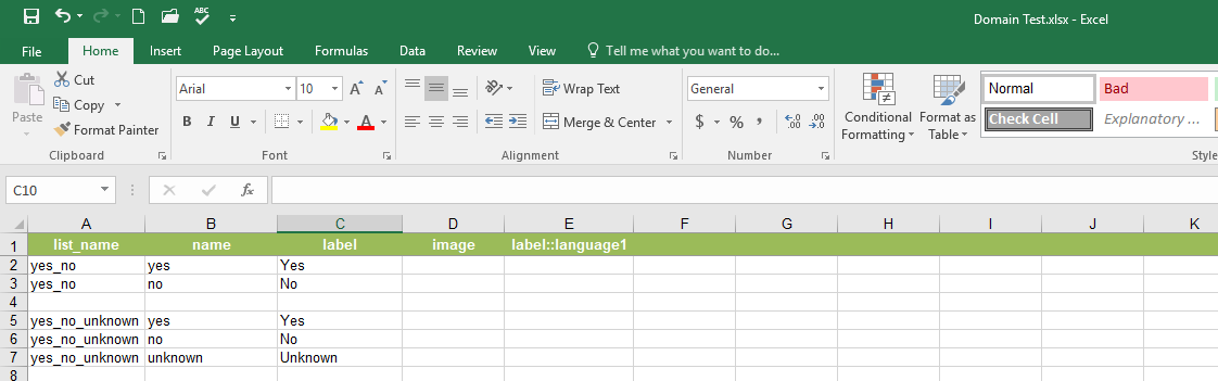

1. Make a choice list
Make a choice list

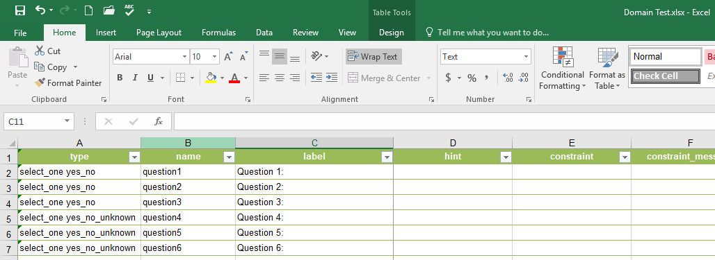

2. Apply that choice list to as many questions as you need to
Apply that Choice list to questions

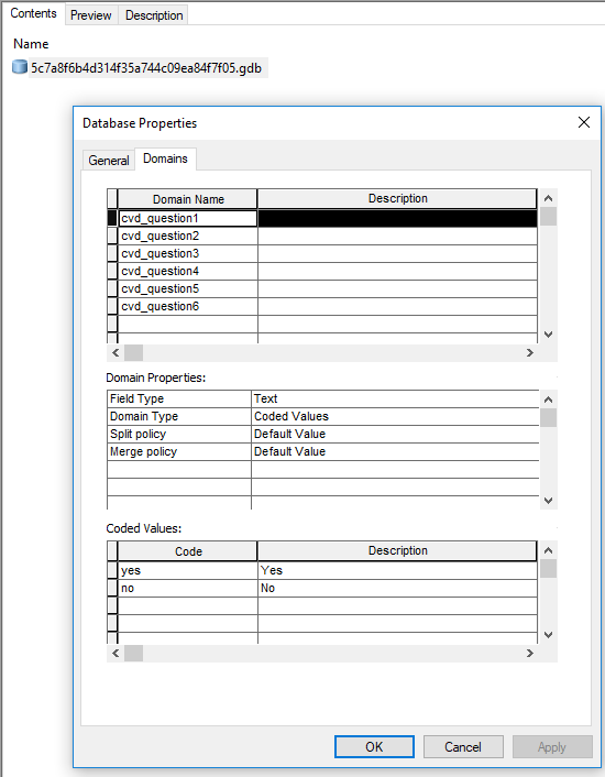

3. Publish the survey, complete surveys, and download the file geodatabase export
4. View the file geodatabase properties and notice the duplicated domains
Duplicate domains
This isn't limited to a single survey we've created or a specific version of Survey123.  I actually created this short one right before making this post to see if it was still happening.  Does anyone have any idea of why this is happening?  Is it an actual bug?  It's been like this for years and I have a hard time thinking I'm the only one to notice it so I'm thinking there is a reason out there I'm just not aware of.  I'd appreciate any feedback, thanks!

Hi KYTC GIS
Thanks for the description and screenshots. During the publishing process, a new domain is applied to each select question as it's created, sometimes resulting in duplicate domains. So what you're seeing is currently expected behaviour, however this issue has been logged as an enhancement request to consider in the future and I've added your notes to it. We'll endeavour to update this thread with any progress.
As you've indicated, this issue could also be raised as an enhancement request via Esri Tech Support so that it gets logged in the Support system with an ENH number that you can track, and other use cases can then be attached to it.
