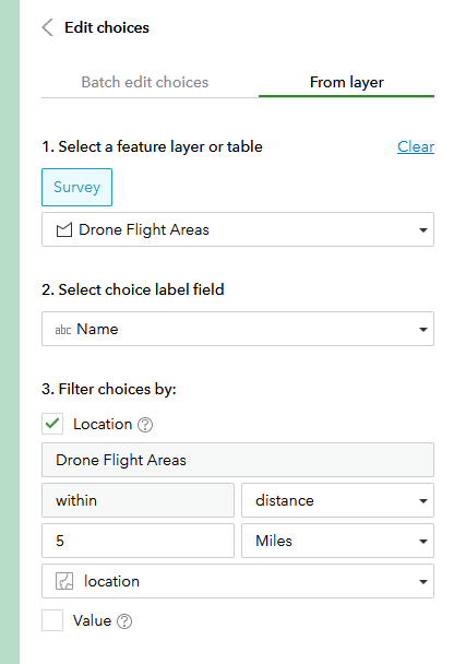

I'm having issues getting a dropdown to filter by a location chosen on a map.
I have it set up to filter by a distance from a point location chosen in an earlier question, but the list always comes up blank. Without a filter, all choices populate. Is there something I'm missing here?

When you set a location filter, the list will be empty if:
  • The location has not been set
  • No features (Drone Flight Areas) are found within 5 miles of the set location
  • The user completing the form does not have access to the Drone Flight Areas feature layer
If you have set a location and you know that there are features within a 5 mile radius of your location, I suggest you check permissions on the Drone Flight Areas layer. If everything looks fine but the list remains empty, we will need to have this looked at by an Esri Technical Support analyst.
Just curious, what is the spatial reference of the Drone Flight Areas layer?
dmitryshab
The permissions seem to be correct, and I've tried extending the distance to 1000s of miles just in case.
Spatial reference is WGS 1984 Web Mercator.
