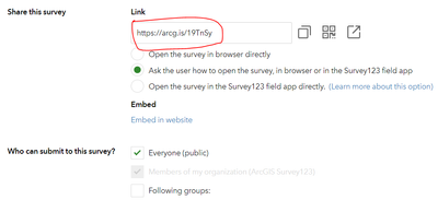

For a citizen science bird survey I have the Survey123 form that can be viewed online via the collaborate link though would like the public survey form to be downloaded and installed permanently on the app. Is this possible with a shared public survey or does it require additional fieldworker licenses? The organisation url login still requires a user account and password. Thanks

On the Survey123 website under the Collaborate tab you can switch the option for Share this survey to "Ask the user how to open the survey, in browser or in the Survey123 field app" which will allow the user to choose. When the survey is shared publicly the link that is generated on the Collaborate tab will work for public users there will be no prompt to log in. You can also share the QR code as well.
