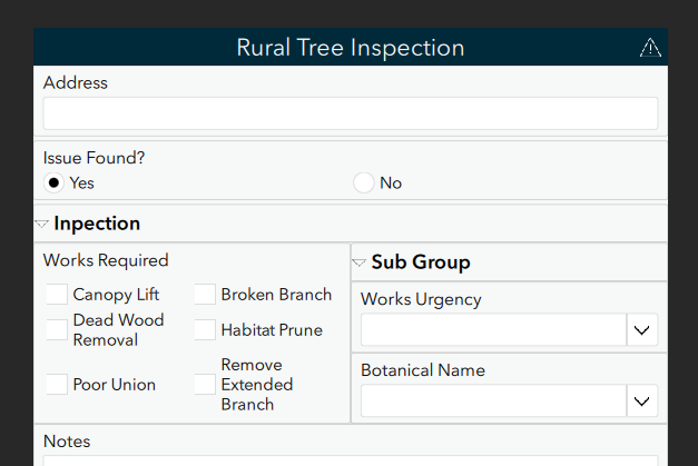

My actual issue, if anyone has any ideas on how to resolve, is how can I hide the bold group names as shown below?
I dont need to waste the space with the words Inspection and Sub Group. I would love for these labels to not exist at all.
I only have them so I can format the works required and (works urgency & botanical name) in two columns as shown below, if this can be done via another method other than groups, i would love to know:
typenamelabel
begin groupgroup_aInspection
select_multiple works_reqdworks_requiredWorks Required
begin groupinspect_bSub Group
select_one urgencyurgencyWorks Urgency
select_one botanicalbotanical_nameBotanical Name
end group
textnotesNotes
end group

Hi Ben,
The short answer is that groups do not require labels.
You should just be getting a warning when converting your form (with no group labels) in Survey123 Connect.
Once you accept this warning message, publishing should go ahead successfully. Can you please confirm whether you're seeing a warning or error message (please share the message) and whether you're getting this message when converting the form in Connect, or when attempting to publish?
