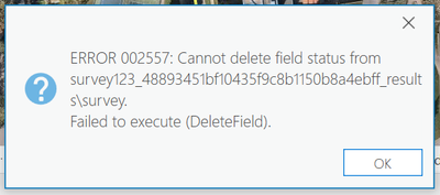

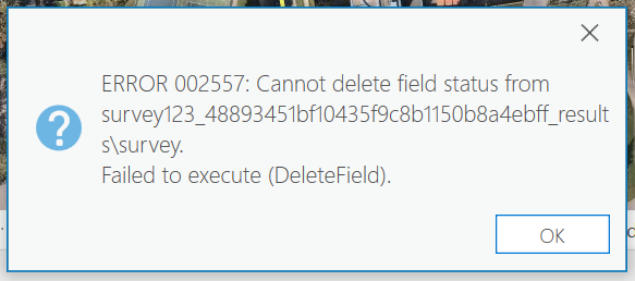

I have created a survey using the Survey123 Web Designer. I created a singleline text field and then later changed the question to single select. In the data tab I see 2 fields with the same name. How do I delete the original field? I have pulled all of my data into ArcGIS Pro and try to delete it there but receive an error.

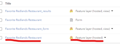

Hello @Anonymous User,
You won't be able to delete a field from a view layer, you will need to delete it from the parent feature service that the _results & _form views point to:
