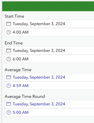

I've attached a simple XLS form to demonstrate this. For example, when entering 4:00 and 6:00, the average without rounding is a minute off at 4:59, whereas the average with rounding accurately shows 5:00:

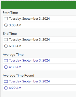

But when entering 3:00 and 6:00, the average without rounding shows 04:30 but the average with rounding is off by a minute and shows 04:29:
