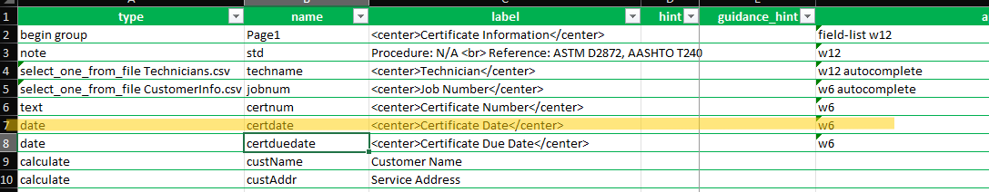

Currently, I have a "date" type question in all of my surveys where a field technician can input the day that they completed their service.  Our review team is mostly located overseas and will review the survey before submitting it to become a pdf report.

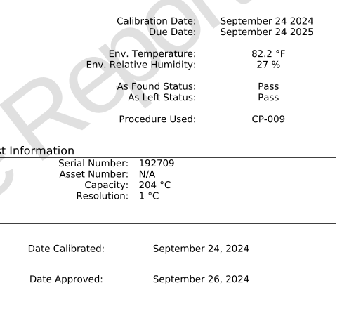

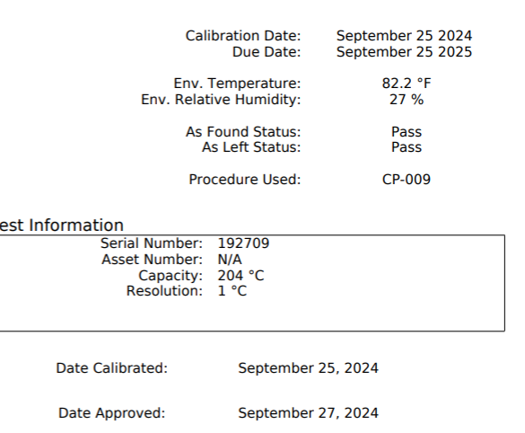

The issue I'm seeing is on my report, the date of service is shifted forward a day.  There is a date type question for the reviewer that is not shifted forward on the report, so I'm assuming it's got something to do with the time zone they're in, versus the time zone the field technician was in when originally completing the survey.  I really need this date to read correctly due to our quality standards.
Since my review team is from different time zones (some are here in the USA, most are in Malaysia), simply putting an offset in the custom report doesn't seem like it would suffice.  Is there something else I could do?

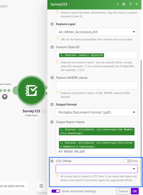

I currently use Make instead of Power Automate, but it appears to function similarly.  I see there's a UTC Offset field that's currently empty.
If I'm reading everything correctly, the UTC offset is specifically for the zone I wish to show on the report, not the offset from the zone the report was generated?  As in, if I put an offset of "-06:00", the report would show the same time/date no matter who generates it?
