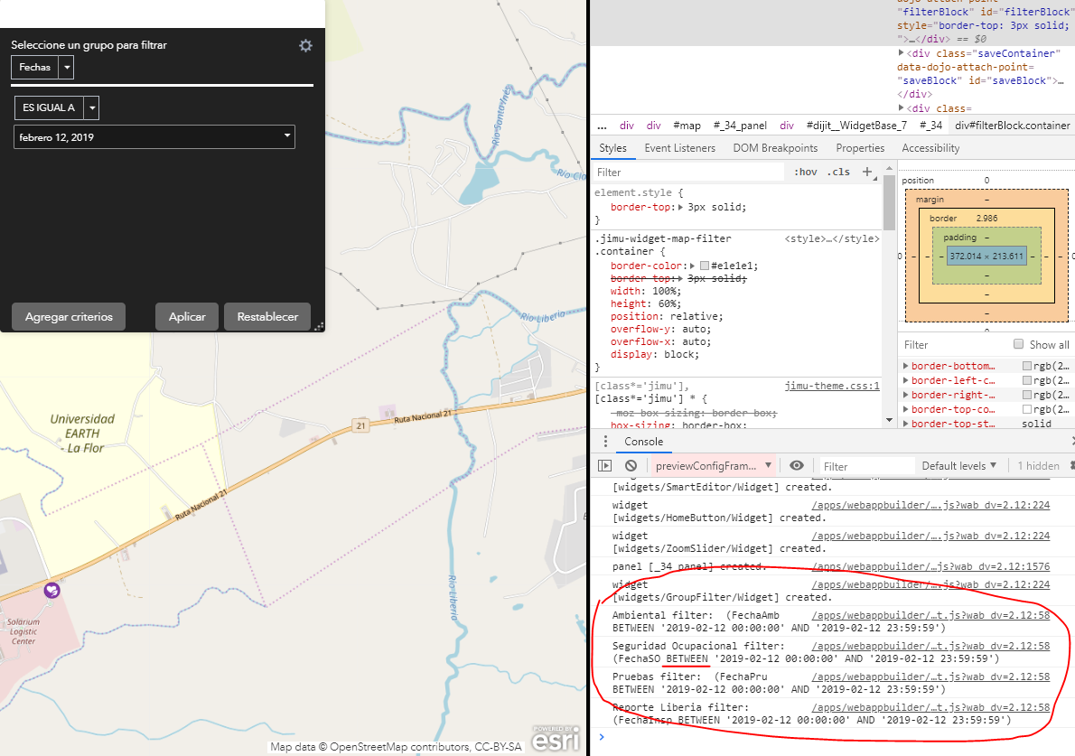

I would like to know if in the last update of survey123 there was a change in the date formats or something similar. We have a problem with a Filter Group in an application in Web App Builder, which filters by the date all the records of a feature service with 6 tables.
Before the last update, the app worked fine:

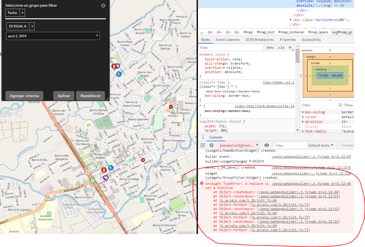

but afterward, the filter does not build the correct syntax for the filter.
Any idea what it is about?

Hi Harold,
It looks like this is an error in Web AppBuilder for ArcGIS‌, not with the survey data.  In the network request list, did a query request actually go to the feature service with the date limitation?
