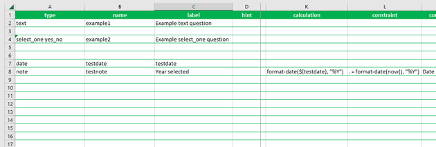

You should be able to pull the current year by using format-date(now(), "%Y"), so if your month-date calculation was working correctly you might be able to add a calculation that checks that the input year is equal to the above value? That being said I can't work out how to put that logic within a constraint on the date field itself, instead having it as a text or note (no field created in resulting service, so cleanest option) field underneath. Like so
And you could add a constraint message saying "Date not within current year" so users would know why it failed. Not sure if this is the most efficient way of doing it but it would work, hope that helps!
