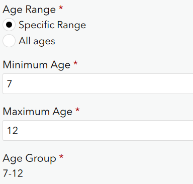

JoshBillings
Yes @Jim-Moore , this would work great!

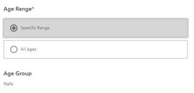

I am running into an issue when I publish it though.
In Survey123 Connect, everything seems to work fine.
However, when I publish this, the Minimum and Maximum Age selections don't show up when Specific Range is selected. Any idea why this could be?
Jim-Moore
Hi @JoshBillings thanks for the screenshots. Not sure what's causing the NaN error in the web app without seeing your XLSForm, but please see example survey attached demonstrating one way to set up the questions. The calculation for age group uses the if() and concat() functions to return the formatted age range.
If you don't want to store the min/max age fields in the feature layer you could set bind::esri:fieldType to null for these questions.
Hope this helps! Best, Jim
JoshBillings
Thanks @Jim-Moore! My error was in the "relevant" field. This works!
