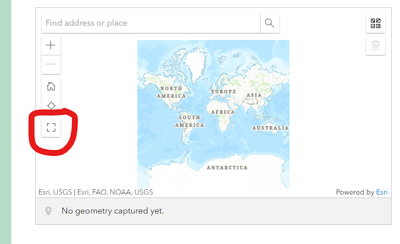

You might be limited on the web, there is a button to open the map larger.

Hey Neal, thanks again for your insights. I'm not seeing any workarounds, so I think I'll add a note to enlarge the map like you've shown as the temporary solution.

@Neal_t_k is spot on the "large map" tool in the geo* question is the best workaround for now, and logging an ArcGIS Survey123 Idea with your use case will help track progress on the request.
