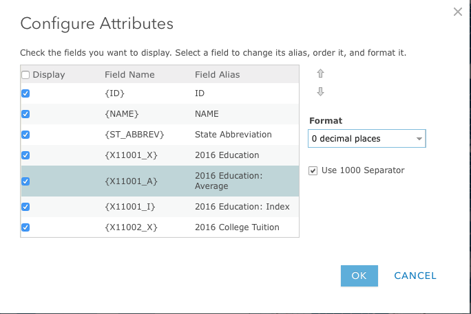

I wanted to include the same XY as my original point but if I can pass a matching asset ID along with using center= its probably not needed. I think I have figured out my problem, but how do you eliminate the formatting rule to pass all decimal values to survey123 instead of cutting it off at 2 places for lat/long?
JamesTedrick
Esri Esteemed Contributor
Hi Adam,
The 2 decimal limitation comes from the popup setup of the layer in the web map:
