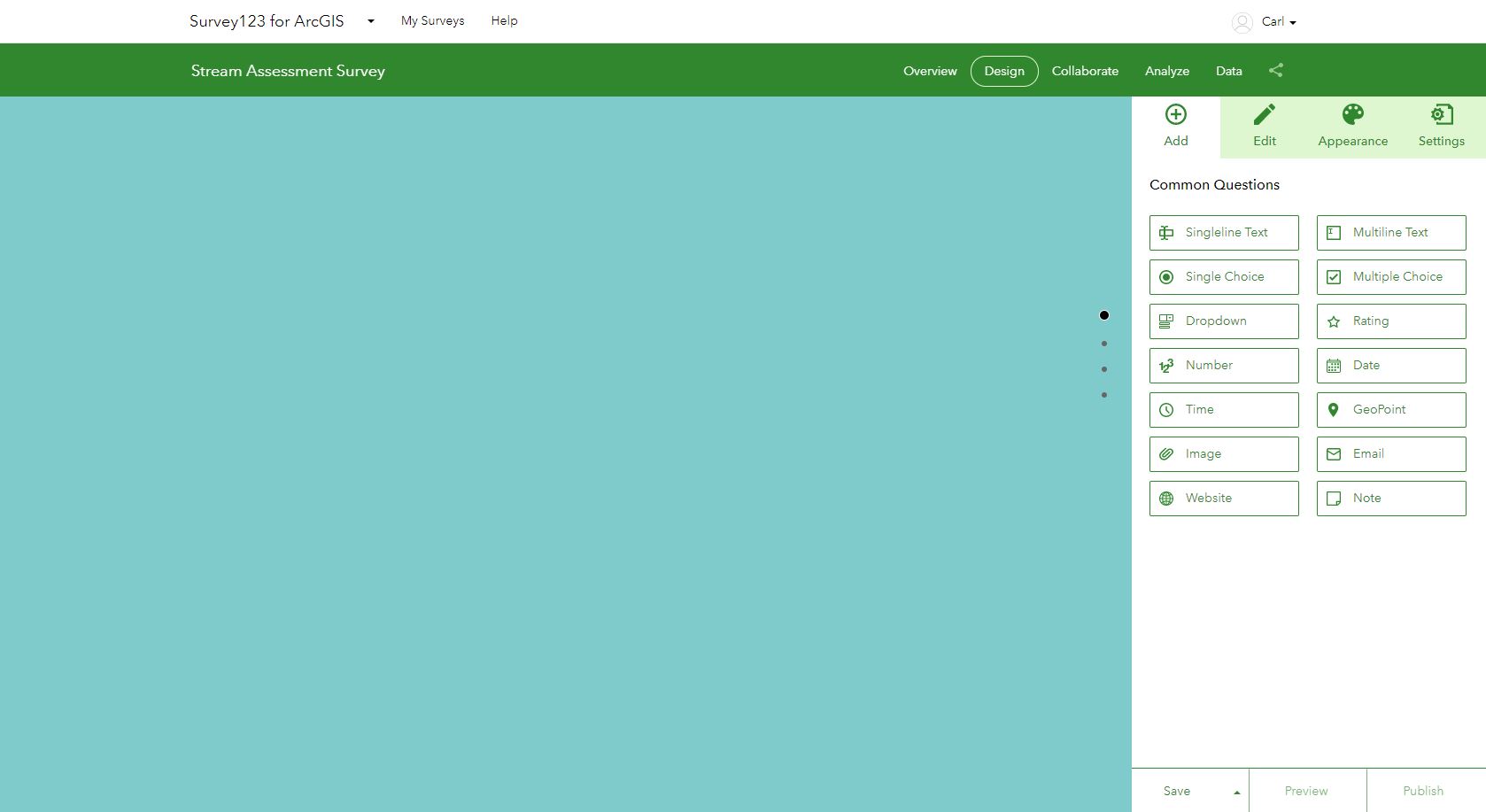

I am trying to edit an existing survey, that was created using the Survey123 Web Designer, but when I open the Design tab I cannot see my pages nor can I edit it. I have deleted the cookies, etc.

Hi Carl,
Are there any errors presented in the developer tools console section?  diligentpig‌, you may want to take a look at this
CarlHolt1
I am not sure where to find the developer tools section, but I cannot select Edit, Appearance, or Settings tab in Design.

Hi Carl,
Developer tools access differs from browser to browser; in IE it's F12, in Google Chrome it's Ctrl-Shift-i .  I can't tell too much from the screenshot you supplied, but it looks like something may have happened to the feature service or form item.
CarlHolt1
User are still able to submit surveys via iPads and view the points on a webmap with no errors.
CarlHolt1
All my other surveys created in the web designer appear and are editable. The other issue is this one survey.

CarlHolt1
ESRI Tech Support was able to assist me in getting the bug fixed. Issue with a special character '%' in the hint field. Used Fiddler to remove it.
