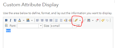

To add it highlight some text and make it a link.
