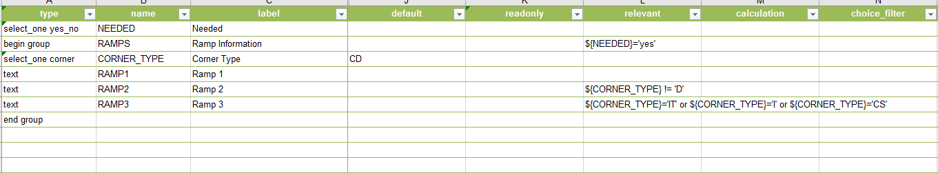

James's reply is one way to do it. Here is another approach. Both should work for you.
