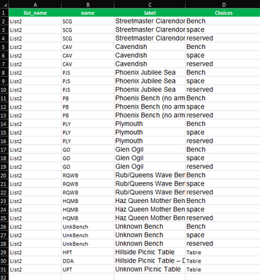

Yes,  you will have to set up the second list with all the duplicate values. One for each option in the first list that you want that item to be available for.
CMcDonald

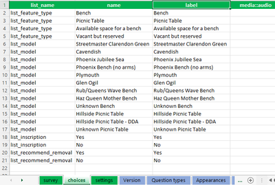

Thanks @Neal_t_k My setup looks a little different in that I don't have a Choices column.

CMcDonald
Thank you @Neal_t_k
Using that guide my setup now seems to work 🙂
