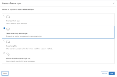

I developed a survey using Survey123 Connect to points to a hosted feature layer.  I created a new survey that is 90% of what I want for a new survey, but I need the data to point to a new hosted feature layer.  How can I make a copy of the hosted feature layer from the first survey to get the submission_url for the second survey?  When I create a New Survey from an initial XLSForm design, the new survey still points to the existing hosted feature layers, so all of the surveys of the existing form are present in this form.  I need to start with zero records for the new survey.  I hope this makes sense.

You can select "New item" in your content and select "Feature Layer", from there you can select an existing feature layer to pull the schema from. Creating that new feature layer with the same schema as the existing feature layer will allow you to create a survey based on the new feature layer with no data.
