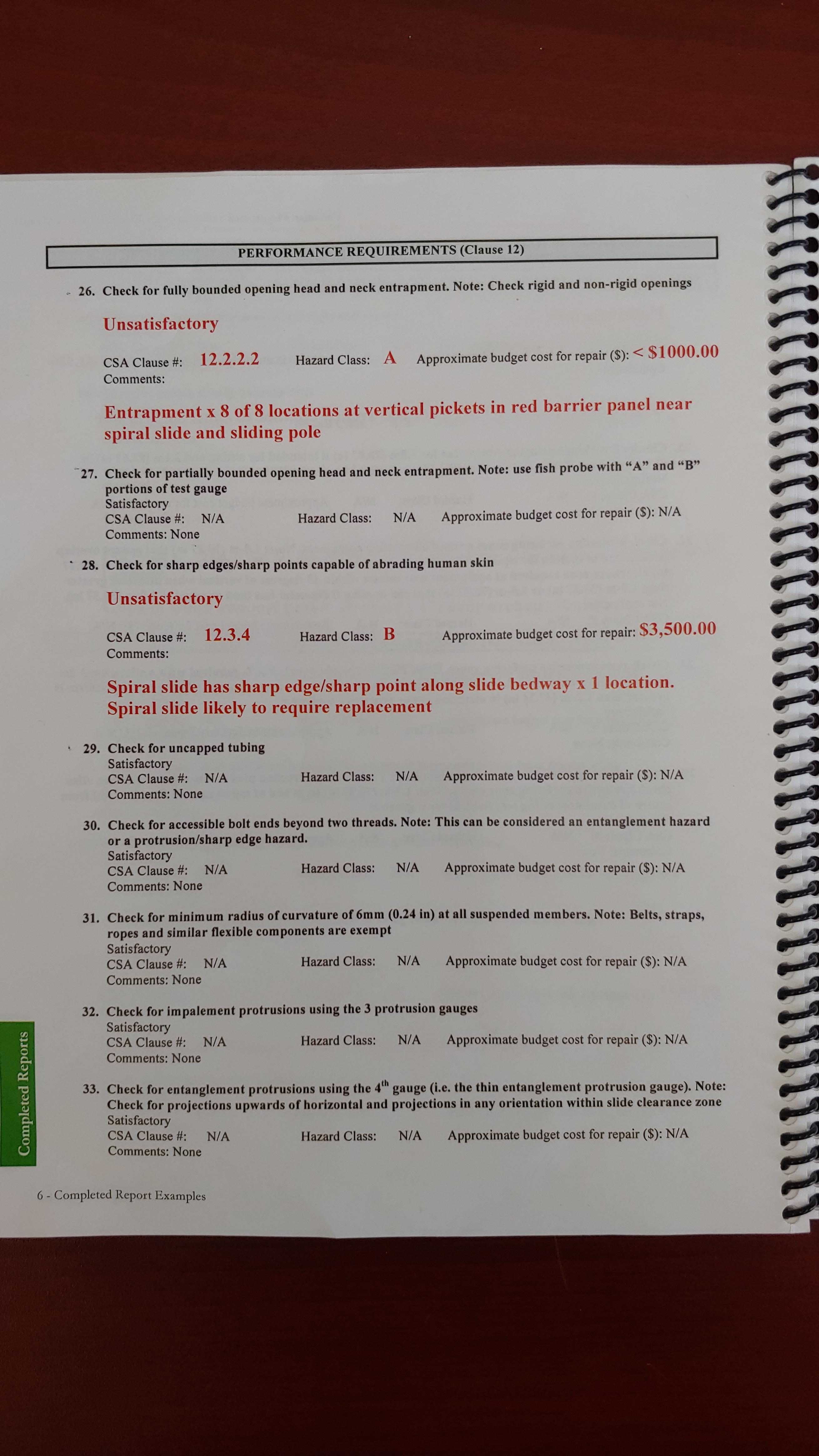

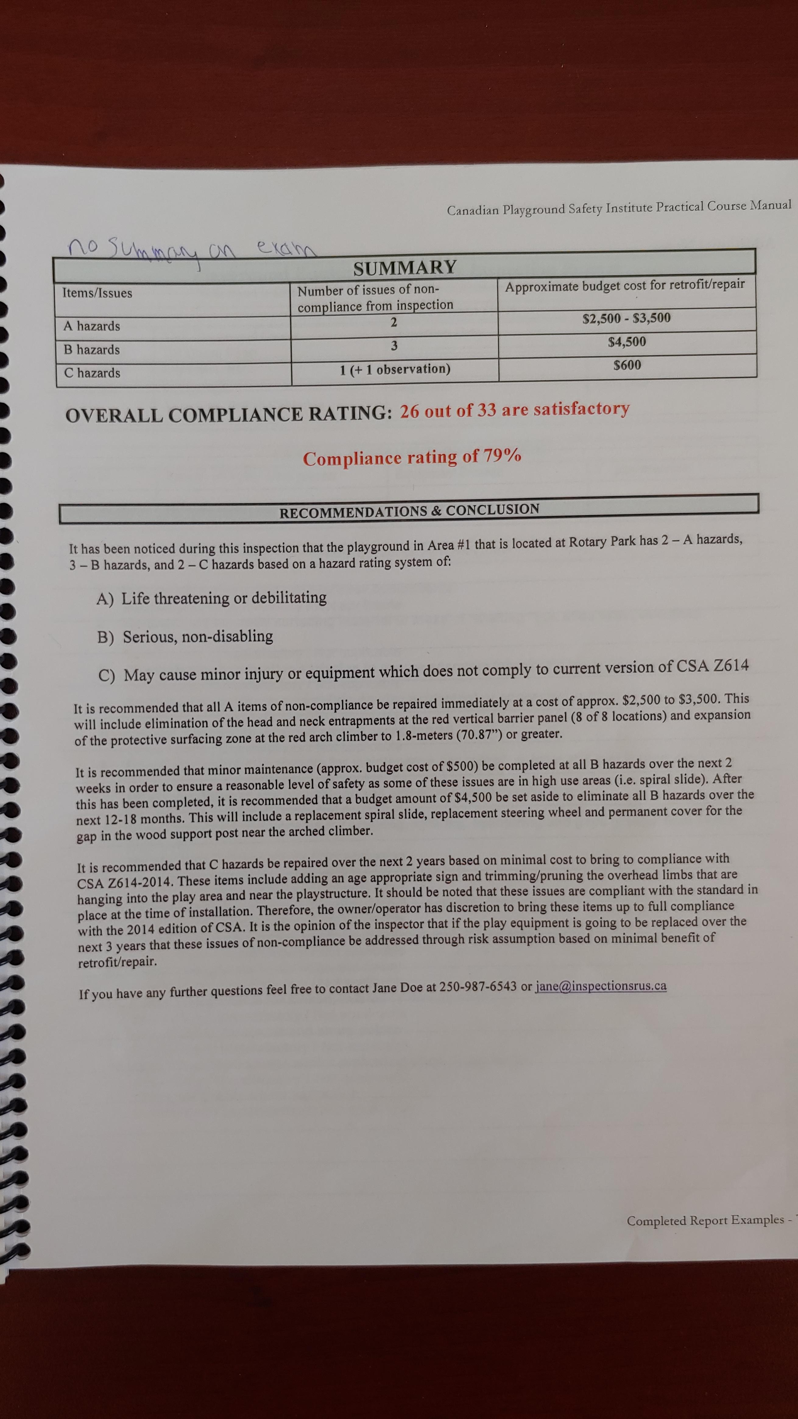

I'm new to this application and I've built playground inspection form (see attached) which is basically trying to mimic layout of CSA standards course book. Layout was easy to recreate but the last section is the SUMMARY which calculates counts of all previous answers to select_one [satisfaction] questions in this report and calculates if the playground in compliance or not once inspection report is submitted.
Questions 1-33 can be answered: "Satisfactory" and "Unsatisfactory" and based on these answers I would like to calculate a Compliance Rating as a permanent field which I can later use in Dashboard etc.
I made these calculations within a Excel spreadsheet but that will not work once I publish this report. What is my best option to perform these calculations which will mimic the screenshots inserted here? How do I not just count the answer but only count answers that are "Satisfactory".

It looks like you are very close to get this done. The bit where your survey is breaking is the logic to sum the pass-not-pass questions; the summary.  In the XLSForm you attached you included some Excel formulas at the end. The Excel formula syntax is not compatible with the XLSForm specification.  You need to tweak the formulas so they are compatible with XLSForm.  You can find a quick reference of the formulas here: Formulas—Survey123 for ArcGIS | Documentation
Just a few ideas that came to mind while reviewing your XLSForm:
  • I think it will be easier if you change the [yes_no] list so the values in the name column are 0 and 1 instead of no and yes.  In this manner, it will be much easier for you to do the sum of passed and not passed questions. I am attaching a simplified version of the form so you can see what I mean.
  • It seems like using the pages style could make your survey more readable.

Thanks a lot for your assistance on this matter. After I posted this question I had the same idea recording Satisfied values as 1 and Unsatisfied values as 0. Then the counting will be really easy by summing up the fields. And thanks for heads up on using 'pages' style to make it more readable. I found Open Data Kit website where all aspects of XLS forms, functions, calculations and appearance settings are covered in detail. I now know how to get this done!
