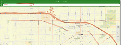

I have an address line in my survey that is provided by the user. I would like that address to automatically appear in this part of the geopoint question:
How can I achieve this? Thank you!

All I would like to do is essentially copy/paste the address information that the user inputs into the field that I highlighted in the above image.

Hi @Hammers211 you're right, geocoding (i.e. retrieving the point geometry from an address typed into a text question) consumes credits when you use the ArcGIS World Geocoding Service.
There's no way to copy & paste the text to or from the search bar in the map window.
Just to clarify, are users entering an address into a text question in the form, that you would then like to paste in the search in the map window? Or the other way around?
