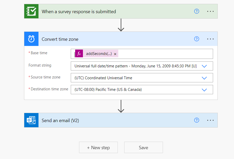

@Ursu_Lacramioara  Date objects in an esriFieldTypeDate column are stored in UTC. That explains the difference you see.
You can convert the time zone as shown in the diagram below. If you are using the Convert time zone module, you do not need to include the date format parameter in the addSeconds operation.

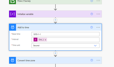

Hi Nicholas - this is what i have in my flows for Add to Time:
Div(triggerOutputs()?['body/feature/attributes/SiteVisitDate'],1000)

Ursu_Lacramioara
do you have this, where Calculated Time equals to body ('Add_to_time')
RutledgeNicholas
@Ursu_Lacramioara This worked perfectly! Thank you!!!
