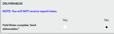

The required column accepts logic statements. I regularly set these up for scenarios like you described.
In my case, I have two primary calculates that every one of these "office only" questions gets:
These are linked to a single select:
And those calculates swaps the questions from "note required":
To "required":
I use the black asterisk as a visual reminder that those question will be required at some point.
