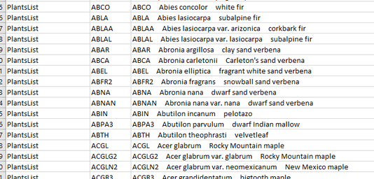

Also I suggest changing your plant list to have name as the USDA code and the label be this with 4 spaces in-between each.
USDA Code    Scientific Name   Common name
That way you store the codes in the data making downstream use way easier.  Also it allows the crew to search by any part of the name they know.  For example they know its a fir and can quickly narrow the list.
This is what we do
