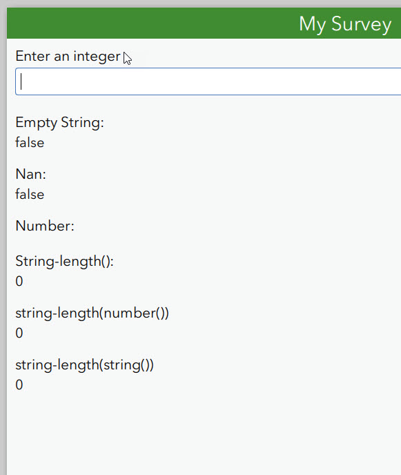

here is the survey with the num1 field empty:
empty

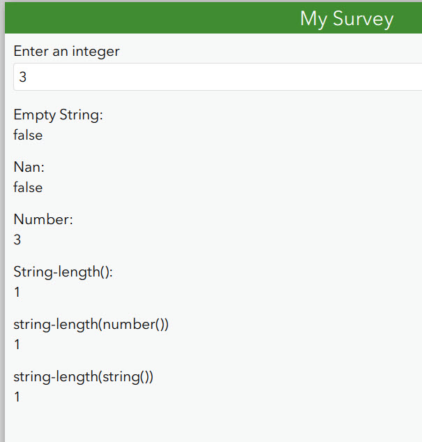

and here with the num1 field with a valid number:
survey

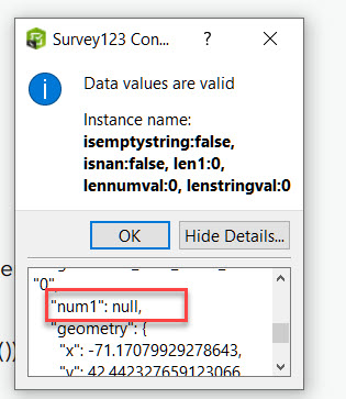

I tried using any of these in a constraint (e.g. string-length(.)>0 ) but that is ignored, or not seen as an issue as it happily lets me submit with this blank integer field.
