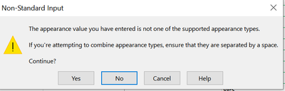

Hi @LouiseHarris1

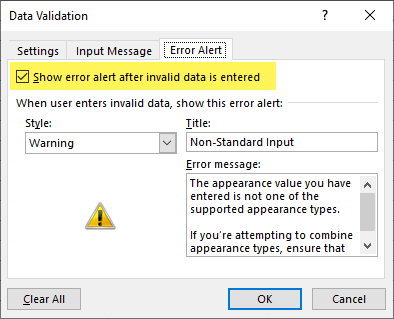

You can ignore this data validation warning by clicking 'Yes'.
You can turn off the warning message (or disable data validation completely) by changing the data validation settings for a cell or range of cells. You'll find the data validation settings on the Data ribbon in Excel:
There are other times when you need to ignore the data validation rules in this column. For example, when setting the 'w' property to set cell widths for grid theme surveys, or when specifying multiple appearances separated by a space. We'll review this warning message for the next version of the template to see if it can be improved.

Do you type this in the appearance field? If so I get this error
