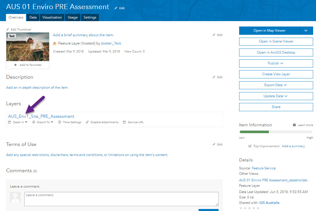

I've been getting duplicated Survey123 feature services (hosted)
duplicates
Seems some of the feature layers were older surveys from Connect, they contain no data.... and is linked to the stakeholder view, so the item can't be deleted.
The layer with May24 has all the records and is currently in use with those using the field app
