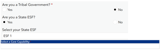

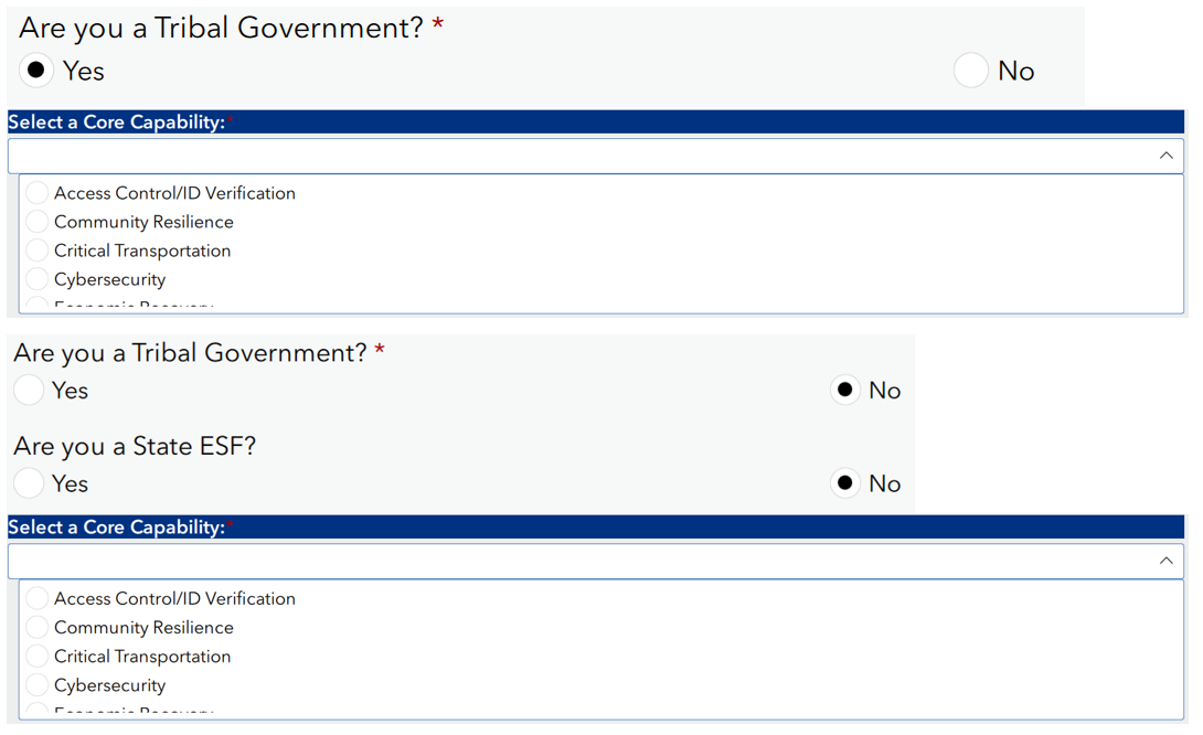

I am trying to configure a survey that applies choice filtering for 3 questions. Here are the scenarios:
1. {tribal_gov} = Yes: show all 32 choices
2. {tribal_gov} = No, {state_esf} = No: show all 32 choices
3a. {tribal_gov} = No, {state_esf} = Yes, {esf_num} = 1 : show 1 choice
3b. {tribal_gov} = No, {state_esf} = Yes, {esf_num} = 2 : show 3 choice
3c. {tribal_gov} = No, {state_esf} = Yes, {esf_num} = 3 : show 2 choices
Some core capabilities can apply to multiple esf numbers
Scenarios 1 and 2 work. Scenarios 3a, b, and c do not. The drop-down option is not available in scenarios 3a, b, c

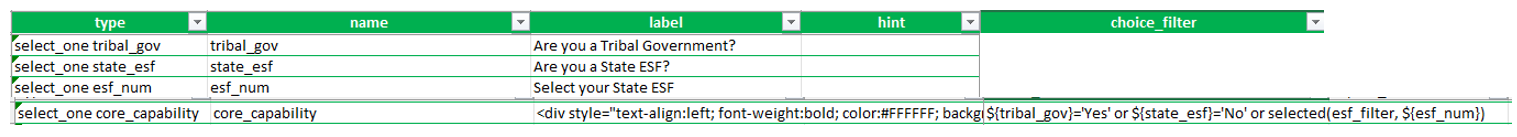

choice_filter statement: ${tribal_gov}='Yes' or ${state_esf}='No' or selected(esf_filter, ${esf_num})
Choices tab:

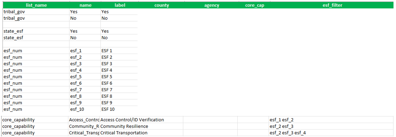

I am adding a space between each ESF. Perhaps that is not correct? esf_1 esf_2

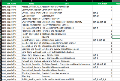

2 things, in your sample the esf_filters are in the media::audio column, they should be moved over a column to the left. And then I think it is all the blank cells in the esf filter column.  I filled them all with zeros and it worked.

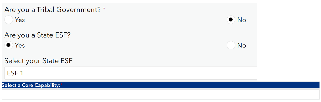

Thanks for the suggestion. For some reason I still cannot get the choice filtering to to work. I have attached a sample .xlsx form if you want to check it out.
Now, none of the scenarios work...but I can't figure out why?
3a. {tribal_gov} = No, {state_esf} = Yes, {esf_num} = 1 : show Critical Transportation choice
Using this ${tribal_gov}='Yes' or ${state_esf}='No' works. It is adding the last part that throws something off

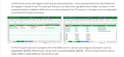

This may help with your multi-option part. You need the comma to separate the list items
Survey123 Tricks of the Trade: Choice Filters - Esri Community
