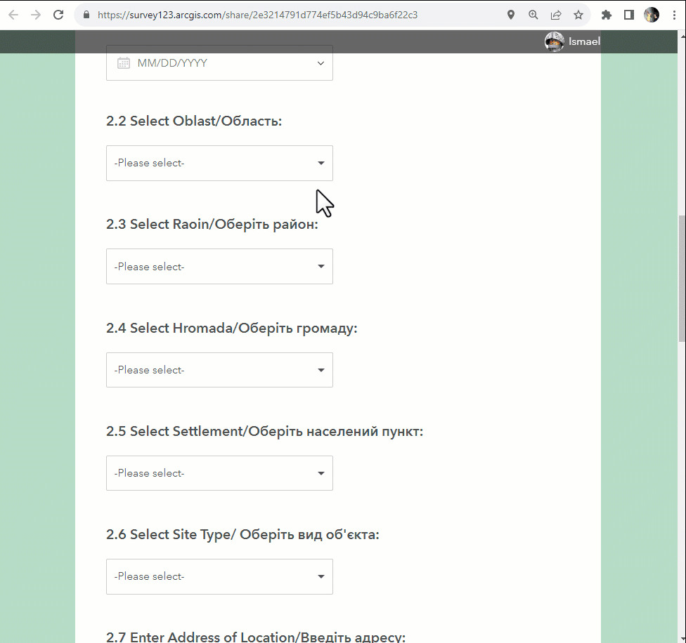

Update on this.
 The problem is in the choice_filter column. You should not use quotes:
  • This is good: ${select_oblast}=adm1
  • This is not good: ${select_oblast}=”adm1”
After making this change, the web app is happy. See below:
