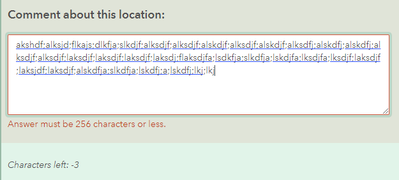

If anyone else comes across this before the bug is fixed, my workaround (publishing in Survey123 Connect 3.16) was to try and recreate the normal behavior of questions with character limits, so the issue would be flagged before the user clicks Submit and a live character count would be provided. It's a more complicated, but makes it more clear to users what the issue is:
  1. On the question with the bug (which was named "locationComment"), I put the constraint "string-length(.)<257" so it would be flagged immediately if the answer exceeds 256 characters, and set the constraint message to say, "Answer must be 256 characters or less." It should say "fewer," I know...
  2. Created a hidden note (named "locationCommentCharCount") that calculates how many characters the user has left before exceeding the limit. In the calculation field I put "256-(string-length(${locationComment}))"
  3. Created a regular note that would display "Characters left: " and pull the number calculated in the step 2. I put the following text in the hint of the question so that the font wouldn't be so large and bold: "<i>Characters left: ${locationCommentCharCount}</i>"

Hi @Marc_Patti, I put type = note, appearance = hidden, and calculation = 256-(string-length(${locationComment}))
