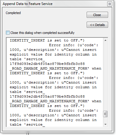

In the past when changing the schema I ....
Downloaded a copy of the data
Published the new form
Used ArcRest to add the data back in
But now I am getting this error from ArcRest.  Guessing its a schema issue
So I instead did a Create Local Copy for editing
Ran the Append tool
Checked back in.
This works great EXCEPT I lose the photo attachments.
Has anyone come up with a good workflow for this?  ArcPro maybe?
Any ideas are welcome.  Hopefully Survey123 will handle this in the future.
