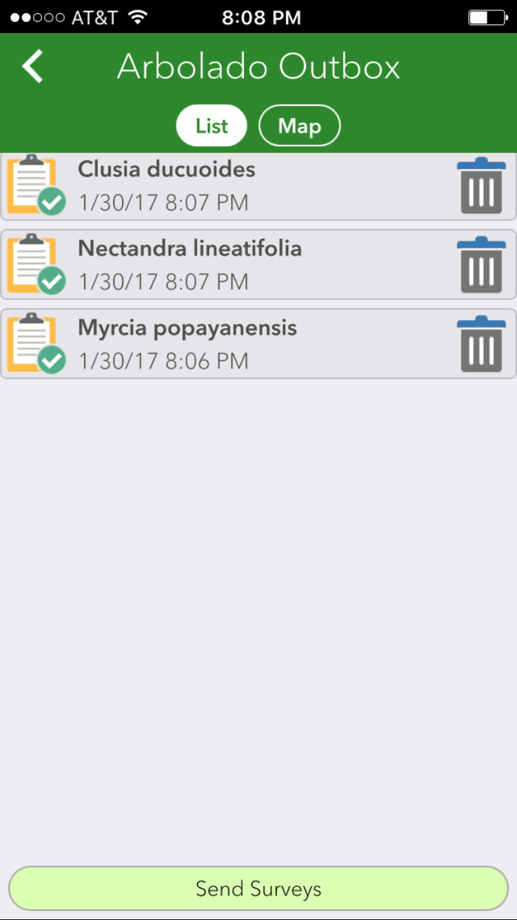

Hi Brian.  The idea of  being able to see all the data that a field user has collected, right from the  mobile device, has come up in several occasions.  One feature we are currently looking at implementing consists on adding a 'map view' option to the Survey123 folders (Sent, Drafts, Outbox etc). Would this do what you are looking for?
AdilsonFurlani
Hi Ismael.
This option to show collected points in a map is very cool and useful, but when I try to use an offline basemap, this basemap cannot be selected in this option. This option show only online maps. My offline basemap work fine inside form, but it does not appear in both Outbox map viewer and Draft map viewer. The same problem occurs in Both in Android and iOS systems.
JamesTedrick
Esri Esteemed Contributor
Hi Adilson,
This is known limitation on the 'box' map behavior.
