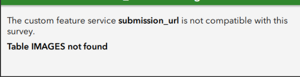

  • I added the Repeat around the image and tried to Republish

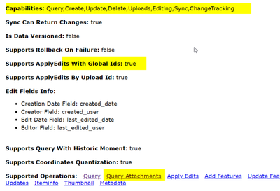

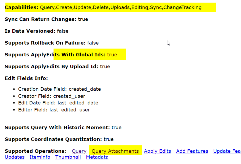

I tried this and got an error ... The Feature Class/ REST Service  should be fine... At Has Attachments Enabled and this

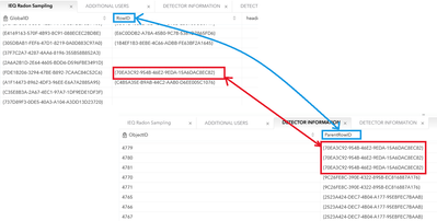

I'd suggest first publishing the survey on its own and having a look at it on your Portal. That will give you an idea of how your external database will need to be set up.
Because you are adding a repeat, you need a related table in that external database. S123 uses two columns to achieve that: uniquerowid (in the parent) and parentrowid (in the child). One minor note, but the json from submissions show "uniquerowid" whereas the web interface shows "RowID". These are the same thing.:
So, your main table will need uniquerowid, and your new related table will need parentrowid to link back to the main table.

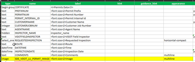

Turns out the Start Repeat and End Repeat are not longer needed for multiple images in 3.1 moving forward.
Just set the appearance field value to 'Multiline'
