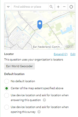

Recently my center parameter in my survey URL stopped working. This is a part of the URL: arcgis-survey123://?itemID=xx&field:callback={BOOMID}&center={LAT},{LON}&etc.
LAT and LON are two populated fields I have in my feature layer which I want to use to set the location of the survey feature. Unfortunately this recently stopped working. I am familiar with this blog post Integrate with other apps—ArcGIS Survey123 | Documentation and with Survey123 Tricks of the Trade: Web form URL parame... - Esri Community
Maybe it's something in the question itself? Obviously when I set the center of the map to this point it gets those coordinates. Setting no default location gives me no location at all.
