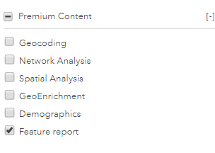

Ah, do you know which role you have? User type is Creator, but your role may not have Feature Report under Premium Content enabled

An administrator or someone granted the admin privilege of Change Roles will need to change your role. Do you have a custom role assigned to you? Maybe ESRI didn't turn on that privilege for custom roles when it became newly available. Even the built-in Viewer role had Feature Report enabled when I "imported settings from an existing role" to see which privileges it has.

As mentioned, if a 'custom role' has been assigned to you within your ArcGIS Online Organization it will be necessary for your ArcGIS Online Organization Administrator to enable the ability to generate reports through the 'Premium Content Privileges' for the custom role. If any of the default roles were assigned to you, they would include this privilege (Viewer, Data Editor, User, Publisher, Administrator).  You or your Administrator may find this documentation handy...User types, roles, and privileges—ArcGIS Online Help | ArcGIS
