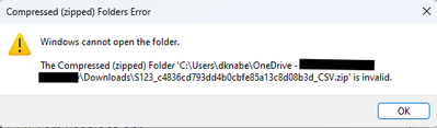

We are using a Portal system. I am currently having issues with exporting selected records to CSV from the Survey123 website. I am able to export all records to CSV and the zip file opens fine. I can export selected records to Excel. However, when I try to export selected records to CSV, I am unable to open the zip file that it creates and get the message below. Any insight?

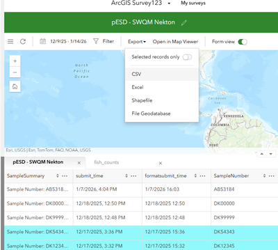

If I choose to export to CSV and DON'T set it to "Selected Records Only" but rather just export the entire dataset (like the image below), the zip file produced can be opened and/or extracted with no issues.

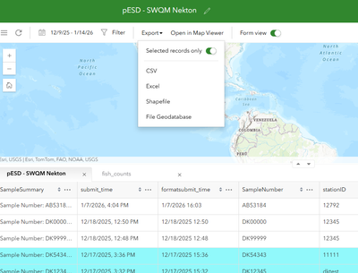

However, if I do choose "Selected Records Only" and export as CSV (see below image) the issue arises.
I get the previously shown error message when I try to open the folder to explore, and if I just choose "Extract All", I get a message saying the file is empty. This happens with every survey I've tried, and I've tried various records within each survey, all with the same results.

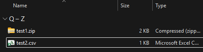

Basically, when you select "Selected records only", it can mess up the file extension. E.g., when you select a single record, it isn't making a ZIP file, it's actually making a CSV. You can see this for yourself if you manually change the "ZIP" file extension to "CSV".

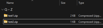

I did a quick test to illustrate this:
  • "test1" was created by exporting to CSV, and "Selected records only" was toggled OFF
  • "test2" was created by exporting to CSV, and "Selected records only" was toggled ON, with 1 record selected
test1 works as expected: I can extract the file to see contents.
test2 works as you described: ZIP file claims to be empty. However, when I change ".ZIP" to ".CSV", I can open the file normally.
EDIT: I only clued in to my mistake as I was hitting "Post". But the above scenario is true regardless of how many records you have selected. I.e., This will happen with 1 records selected, or 100 records selected. Ignore the "1 record selected" statement.
