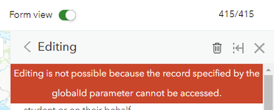

However, today I was greeted by the following error:
"Editing is not possible because the record specified by the globalId parameter cannot be accessed."

No apparent impact. I reloaded ArcGIS Survey123 and attempted to toggle Edit for a record. The original error was still there.

After doing all this, the error persisted.
