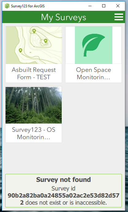

did you ever figure this one out. I am having the same issue when I launch from collector (or web map) on both desktop and ipad. the weird part is that I can see the survey (the one with the leave called Open Space Monitoring), and launch/fill it out from the menu, but I can 'call' it from the link I created in the web map.
Am I missing a permission setting somewhere? I had this working last spring just fine in another survey so I know that it works (I referenced the same links that were mentioned in the original post above).
Survey (Open Space Monitoring) is in the list of surveys, but error saying survey not found

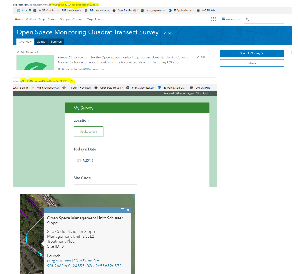

Can you confirm the itemid of the survey you have downloaded in the app in screenshot, and the itemid in the URL you are using is the exact same?
Also is the app signed in with a user that has access to that survey in the screenshot above?

Thanks for the reply. Yes, as far as I can tell the id is consistent. (see screen shot)
I am signed in as the group manager, so I should have full permissions to do what I need to do and test things. again, the "Launch" in the Collector pop up does open Survey123, but it doesn't recognize the survey that I am calling (even though it's sitting right there in the app's pool).
